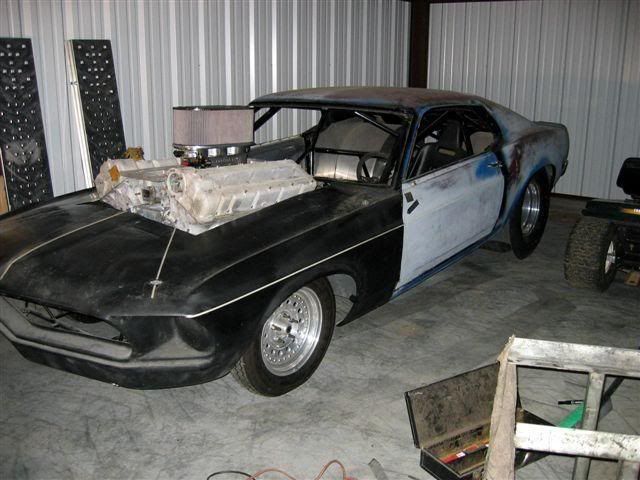

Here is some FORD POWER for you direct drive guys...
1100 cubic inch All Aluminum Block
500 hp Capable of much more
1050 foot lbs/torque
Factory Billet Crank
Shaft driven DOHC 4 valves per cylinder and dual mags

Postby jdotson » Wed Feb 28, 2007 7:44 pm
That must be the John Holmes of Mustangs! :shock:

Priority1,
I'll up the annie' to 2 kids and 2 grandkids :D
Is that thing real :shock:
See they even put the distributor in the front where it spose to be! I think that's a distributor aint' it :roll:
Awesome Stang! Vette spanker for sure!

Postby jrstultz » Wed Feb 28, 2007 8:22 pm
did I read that right, 500HP ?

Priorty1
Posts: 99
Joined: Tue Oct 18, 2005 8:31 pm
Postby Priorty1 » Wed Feb 28, 2007 9:03 pm
It's for real the motor was built in the 1940's for the Sherman Army Tanks.
Dual mags and yes Basket they are were they should be up front
:lol:
